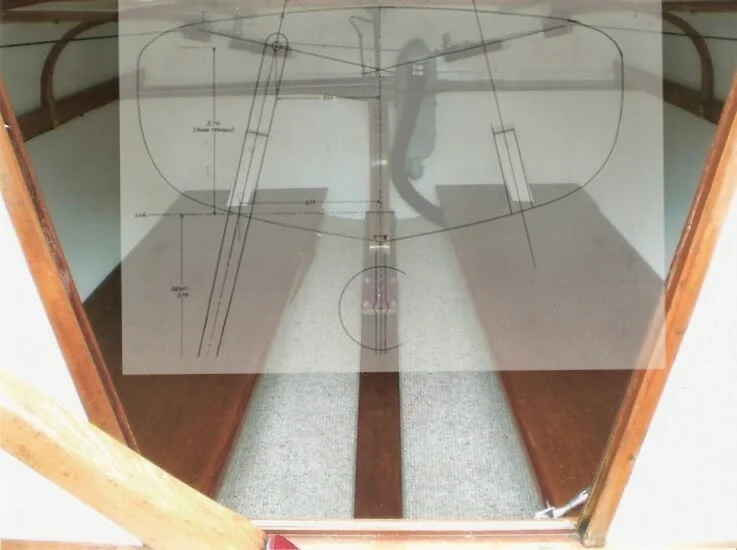

Thanks to some good drawings done when the twin rudders were done I can get a good idea of how things are going to lay out. From this I can see where the rams would go, I hope that I can work around the exhaust.

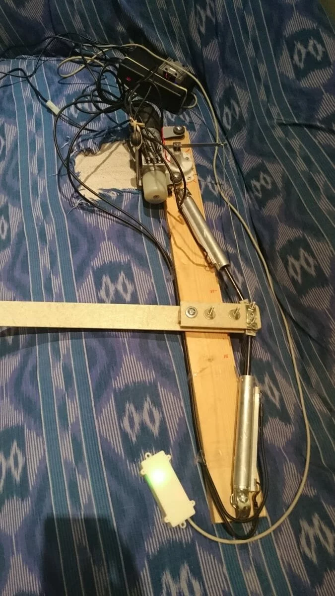

Ok, so I have actually been doing something.I can’t just turn up to the boat and hope it works so I have created a test set up. It is made from an old batten. The pivot point is the left most bolt, I left the length to the left of that to see the speed of movement I would expect from the actual rudder.
From the top; The black box you can see at the top is the project box that contains the arduino and freeboard circuit boards as well as the bluetooth module. You can just make out a red dot which is a 4 digit 7 segment display which I initially used to indicate direction. The metal bit on the top is the motor controller heat sync.
Then coming down you can see the motor and to the right of that the rudder position sensor. There is a bit of fencing wire between that and the end of the ’tiller’.
This is now stand alone and powered by a 12volt car battery I have under my desk.
The cool thing is that I can set the rudder position and it moves to that position.
The difficulties I have between now and a usable system is the quality of the compass which I hope just needs calibrating properly. Unfortunately I have an iron girder near my desk 😉
The other thing that I see as a risky area is the control loop for that includes the compass. I can use the COG from a GPS I have, this de-risks the use of the compass. But it is the tuning of the feedback loop might phase with the motion of the boat if it isn’t tuned properly.
I am using a basic Phase, Integral and Derivitive (PID) loop which I might have to tune based on wave size. I am not sure…

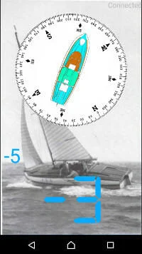

The thing that has made this quite cool is that I have managed to use a bluetooth low energy link to my mobile to do the configuration. The only problem is that I spend too much time making it ‘pretty’ and not enough making it functional. I am learning a lot so sometimes it is more ‘look what I can do’ as opposed to what I need to do.
I hope nobody minds as I have lifted the background image from the Atalanta brochure. The centre of the compass is also an edit from the line drawing.
The idea is that the outer compass is driven by the phones compass so it always points north. The image for the boat rotates within that pointing to its compass bearing. So the image should be aligned with the boat.
The bottom of the screen is, at the moment, three swappable panels for bearing, rudder and GPS speed (obviously, that is important). In the one pictured the smaller number is an editable field which gives the rudder position wanted. The big one is the actual position. I edit the little one and the big one aims at that number. For the rudder it works.

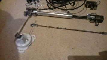

Fairey MaryParticipantI have just packed up the hydraulic rams with the brackets I have had made out of 3mm stainless. So if I have done my maths we should be fine mechanically. I will need to make up a wooden base plate which attached to the top of the old centre rudder stock.

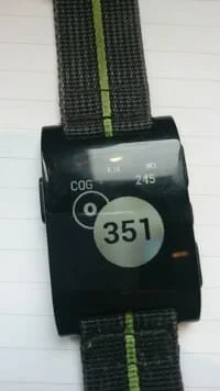

The electronics took a bit of a turn when fear of dropping the phone got the better of me. I bought a pebble. For those not familiar it is a ‘smart’ watch. Where in this case its intelligence is mostly in keeping it simple. It has a persistent display. I think it is a sharp memory LCD and not exactly an e-ink in the style of the book readers.The benefits to sailing are that the display is always on and is readable in the sun. Unfortunately the choice of poly-carbon means that it is not exactly polarised lens friendly. But better than an LCD at the wrong angle. Also the big buttons are easier to use than a touch screen when your hands are wet. The thing that surprised me a bit is how light it actually is. It isn’t that difficult to write code for the phone as it is well integrated into the phone. In fact I had a working prototype in a Sunday afternoon. It has taken me days to bring it up to what you see below.
The way I have ‘designed’ it is that up and down keys go up and down by 10 units. The autopilot has 3 control modes compass, GPS (COG shown) and Rudder. The method is chosen by the phone app by virtue of the last setting configured. This is reflected on the watch as the figure top right, the wanted direction. The large figure is the actual measured value. So that would be rudder position or bearing of some form. The text top left is the controller chosen. The number in the outer circle is the speed over ground. I have changed the font since this picture to try to get 3 digits in. The pebble really just acts as a remote control for the phone. There is another neat trick I should do something with. It is a good MOB alarm. All tied in I can turn to wind if the watch gets disconnected from the phone. I just don’t know where the wind is yet…
